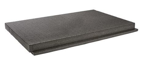

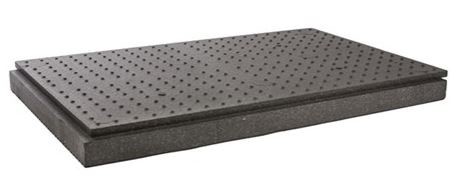

The idea with the tracked ones is probably to create paths for the air to travel between the board and the existing wall.

Yes, I also mean that the tracks should be against the wall and not against the plaster.

No, that sheet has knobs on the wall side too, for an air gap.

b8q said:
Not at all, that board also has knobs on the wall side, for an air gap.
This is what it looks like, outside and inside respectively:
A rectangular, ribbed surface panel shown from above, likely an exterior or interior construction element.
Perforated black panel shown from the outside, lying flat.
