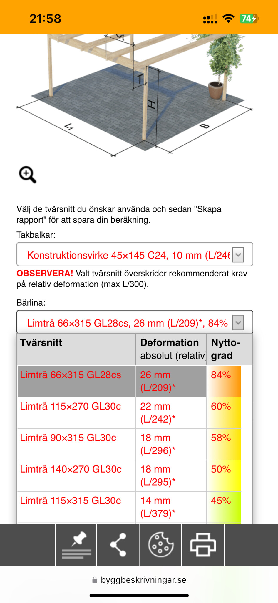

I'm thinking of building a pergola over the outdoor kitchen.
If you check the Swedish Wood dimensioning guide, you should have sturdy dimensions, which will be hard to lift.
The pergola is 5.40 long, where it is critical, with one pillar in each corner.. will it be enough with a 90x315 or 90x360?
According to their table (deformation) it's 19mm on a 315, does that mean it will flex that much?

A pergola has no roof, you don't get any snow load, it just has to carry its own weight. So you can have a 45x170 if you want. Where does Svenskt Trä say you should have 90x315 for a pergola?

Maybe it's exaggerated?
  • 3D model of a construction project with a grid showing measurements, deflection warnings, and material selection for beams, with an option dropdown.
Not only the load-bearing capacity is important, but also the proportions of the construction. You often see visually too weak structures, it doesn't look good.

Adding braces makes the entire structure sturdier and you can reduce the dimensions. The pergola is usually not the main focus and it's good if it's not too bulky.
