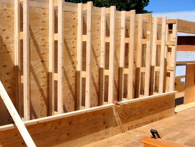

Hello,
We would like to build a passive house and are thinking of doing it ourselves. Quite often, one uses I-joists, but here in the link, it states that they have 10% worse thermal bridging than 'larsen-truss'. https://emupassive.com/2021/06/10/thermal-bridging-of-i-joist-vs-larsen-truss/#:~:text=A Larsen truss, with its,web of an I-Joist.
My questions:
- Does anyone have experience with them?
- Can they be built on site or do they have higher requirements?
- Alternatively, where can they be purchased?
We will be building a 1.5 story villa, so load-bearing strength doesn't matter.
Thanks in advance and have a good day,
Sander from Skåne.
Image from: Bruce Coldham
I will also be building a Larsen truss (on-site) in a new two-story building. You can absolutely do this yourself if you're handy with tools. Talk to a local architect to find out connection details to ensure that thermal bridging and moisture reduction are addressed (especially at window, roof, and foundation connections).meijer3 said:

They are better for insulation and easier to handle.

Make sure ventilation, heating, airtightness, and thermal resistance (insulation) are coordinated and balanced. Therefore, it's a good idea to talk to an architect or a passive house consultant who has the software to calculate this. Good luck!
