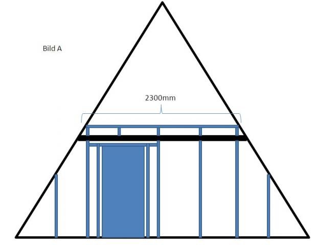

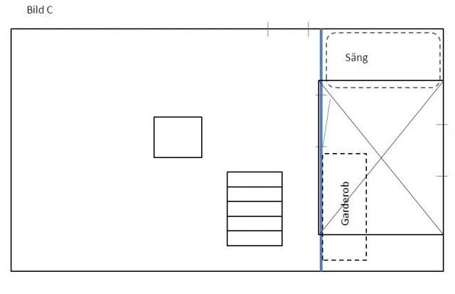

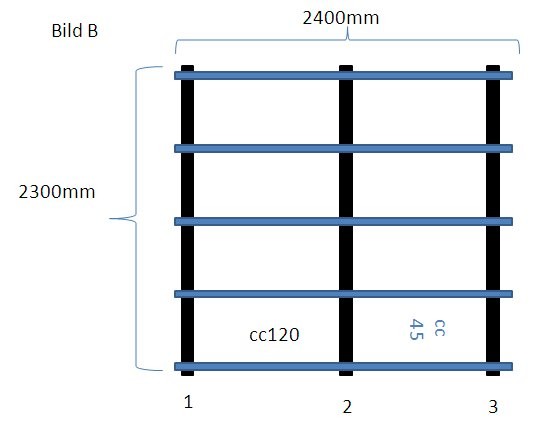

Here are some sketches. Unfortunately, I don't have a good drawing program so they are poor power points, but hopefully, they give a clearer picture of what I need help with
Image A: Cross-section of the construction with roof trusses, new interior wall
Image B: Example of the loft's floor structure
Image C: Overview floor plan of the room under the loft.

As I see it, there is no problem unloading Beam 1 and 3 as shown in image B, given that a new interior wall will be built for the room under the loft at beam 1 and that it can be unloaded at the gable/beam 3, but the loft's floor structure will then rest freely with cc 120 on beam 2 since there will be free floor space under in the room.
Is this a safe construction? If not, is there any smart solution to this?
I don't mind if it flexes since the loft will only be used as a sleeping place for guests occasionally and for minor storage.
