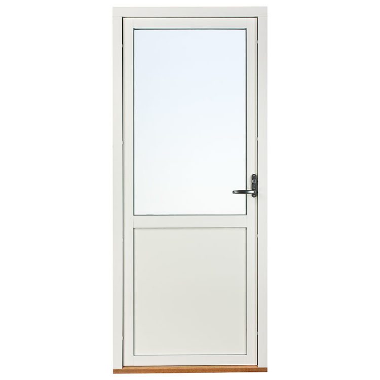

In the kitchen, we have a standard-sized terrace door (glass on the upper part) that lets in sunlight right where you stand to cook. Now we want to manage this, and the first thought is, of course, an indoor blind. But this means that the heat would still enter the kitchen.
Do you have any suggestions on how to solve the problem? Maybe you have done something similar yourselves?
