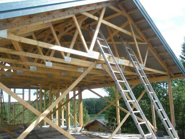

I am building a carport with an attached heated section. The exterior walls and the roof are finished with concrete tiles. The span of the roof trusses is about 8 meters. The trusses are of the "storage truss" type, which allows for flooring to create storage space.
I have a fine pillar drill press that weighs about 300kg, which needs to be moved into the heated section. I was thinking of using a chain hoist attached to a beam that runs across the lower part of the trusses and lifting it from the garage section to the heated section (which has a floor height about 30cm higher). Now I'm wondering if anyone thinks the trusses might not be able to support such a weight? The lift would take place approximately in the middle of the trusses. I'm attaching a picture of the garage before the exterior walls were finished.

I would recommend that you ask your takstolskonstruktör.
It should hold, given that a reinforcement has been placed in the middle of the truss. But to be safe, I would support the truss with a stud/plank from floor to truss on either side of the lifting point.
One of the trusses serves as support for the wall, so there's only a hole for a double door, about 180cm. *Glömde* The wall studs are thus nailed to a truss except above the door. It should hold?
I used my trusses to lift an IPE beam that weighed 330kg.
My trusses are also w-trusses, span 7m, and homemade by me.
For safety, I attached the chain hoist to a sturdy beam that I placed between two trusses, thus distributing the weight to two trusses.
I couldn't notice the slightest flex when I lifted the beam.

Lifted a significantly heavier machine in weaker roof trusses than yours.
Distributed the load over two roof trusses and also had two supports of 50*100 between ceiling/floor on each truss.
No problems anywhere.
