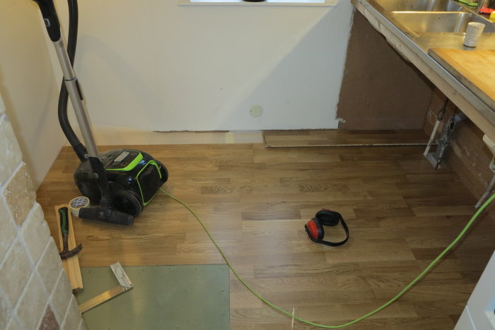

Unfortunately, I don't know how much should be cut off, but the room's dimensions are:
width: 2.87m
Length: 4.3m
There's quite little waste with click flooring. I recently took a chance and bought 11 packs with 3.18 m² per pack, totaling 34.98 m², when the space was 33.8 m². The space is not square but extends over several rooms, which increases the waste. In the end, I had to buy an additional pack because a piece was missing. If the space is square, I think you'll manage with 5 packs. If you want to be sure it’s enough, then buy 6 packs.
5 packs are enough with a board's margin. If you have about 30 cm overlap.

K Kane said:
5 packages are enough with a board's margin. If you have about 30 cm overlap.
30cm sounds quite a lot. Good that I bought 6 packages.
Here you can see how much I was missing in the end. But I am not more than a mile from Byggmax. So it wasn't a big risk to take. There were special circumstances with the shape of the space that increased the waste a bit.
Vacuum, tools, and hardwood floor installation in progress in a kitchen space.
Revy said:
30cm sounds quite a lot. Good thing I bought 6 packages.
30 cm is good. If you go smaller, you'll use less flooring.

A Avemo said:
Here you can see how much I missed at the end. But I live no more than a mile from Byggmax. So it was not a big risk to take. There were special circumstances with the shape of the space that increased the waste slightly.
[image]
Ahh that was a shame, but good that Byggmax isn't far, hope it worked out!
