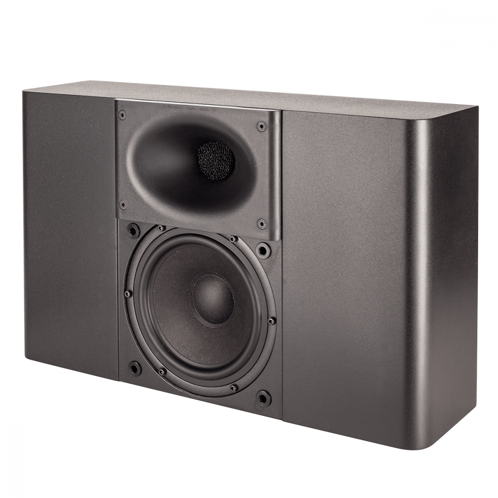

The speakers are a closed construction, so there should just be adequately sized "holes" in the wall to place them there. If I go with aerated concrete, it's more about building an opening for them; the wall itself won't be a speaker cabinet (as I think you assumed?)
Picture of the speakers to be embedded:
So the whole wall only needs to be about 15 cm thick (from the front edge of the MDF to the old wall). So for example, 95-stud + 2 gypsum x13mm + 1 MDF. Do you think your framework suggestion would be better anyway?

I had placed them with foam between the speakers and the wall to "decouple" them. Then ignored mdf. Single layer of plasterboard - only. There's no reason to make a super-stiff baffle if you're not going to attach the speakers to it... mechanically, that is.
Instead, set a rule to "stand" them on.
