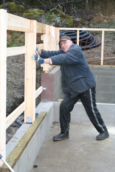

Yes, the father-in-law could let go and it stayed put!
The back part that's built higher is screwed with special screws and plugs that I bought at Beijers for the purpose. I can tell you it was super expensive, don't remember exactly how much it cost, but it was several hundreds for that small supply. It wasn't as stable as chemical anchors.
If it's a high wall, I would definitely use chemical anchors and post shoes, imagine if someone leans against the fence and it gives way? Leca is quite porous so it might be problematic to get anything else to hold. Chemical anchors in a leca wall become very solid, it's as if the post shoes were cast into the wall.
It's also relatively little work, drill holes, spray in chemical anchors, press down the fittings, and ensure the chemical anchor fills out.
I'm going to put down more fittings in the slab and wall, will definitely buy another cartridge!

Yep, see the previous addition.Funkybase said:
I used 25 mm, that's what I had, maybe something smaller could have worked. I should add that I had post shoes for thicker posts (95x95).Funkybase said:
Ideally, you would drill deep enough to reach the bottom, but it's probably hard to drill with such precision. I think I put a piece of tape on the drill bit to see how deep I should drill and went about half a centimeter deeper. There's a lot of dust in the hole, so ideally, you would have compressed air available. I didn't. The mass didn't want to stick in the wet state to the walls of the hole due to the dust, but it doesn't seem to have impacted the result. I placed a couple of strips between the wall and the underside of the post shoe to fix the height.Funkybase said:
Depends on the temperature. It dries relatively quickly. About a day with the current temperatures, I recall (but I might be wrong). You could use it (Sika's) at relatively low temperatures as long as you made sure the chemical anchor was warm when you used it.Funkybase said:
If there's not too much slope on the wall, I would aim to drill straight down instead of trying to bend the pins.
