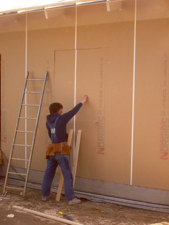

Very good suggestion above, and that's also what I usually do with windows/doors, i.e., put up virtually the entire sheet, take an old/cheap handsaw and cut the plasterboard horizontally, then take the plasterboard knife and cut vertically - snap!
Saw external plasterboard:
http://www.familjenlindstrom.se/images/byggahus/stomme/vagg.jpg
ByggaNytt said:
Very good suggestions above, and that's also how I usually do it with windows/doors, i.e. put up almost the entire sheet, take out an old/cheap handsaw and cut the drywall horizontally, then take out the drywall knife and cut vertically - snap it!
Saw outdoor drywall:
[link]
Thanks, but this is about the inside!
David250 said:
Thank you but this applies to the inside!
Exactly the same principle can be used for the inside as well.
