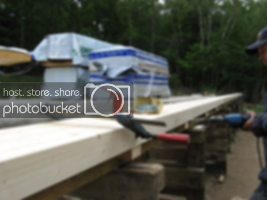

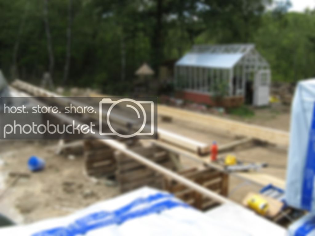

so it was time again with 20 pieces of glulam, 13.5 meters long and 315X95. The wood holds K24. Some screws have been purchased at Biltema
6X180 mm = very high quality, probably the same steel as in reinforcing bars :D

Can you add some questions: what kind of glue do you have? How do you ensure the beams are straight? What will they weigh when finished?
Mikael_L
May one place an order for a balk if the need arises?
:D :D :D
I'm a little impressed, wasn't it you who made pre-stressed laminated wood beams earlier?
Biltema's white wood glue, waterproof, works well. I've welded together 14 angles weighed on the pallets, which I pack the beams on, glue and nail together with the nail gun, and screw. Weight = about 200 kg. Yes, I have manufactured the same type for the garage before, but then I built them vertically and assembled them by hand with 5:or. I have 50mm overlap on these, but there will be no sag, so the roof will be a bit humpy, but that way it looks fresh. Buying this number of beams ready-made would have been expensive, and transporting them would have been a problem. Thanks for the interest.

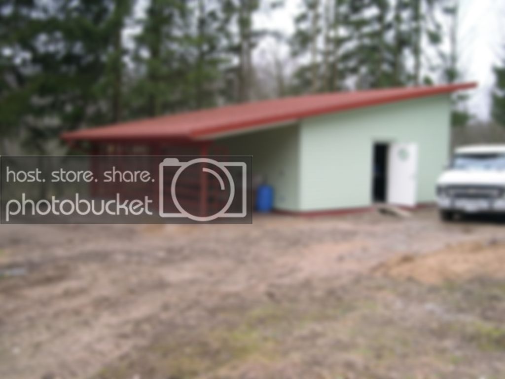

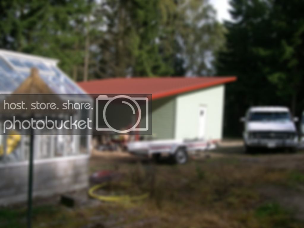

Here are my previous glue-laminated beams = model "pro"
